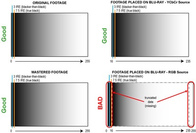

Basically, in YCbCr mode, full range signal (0-255, which it can do) is not allowed and limited range values are specified (16-235 for 8-bit color sources). Initially, analogue sources & displays had something called under- or overshoot which in essence took into account the 1-15 and 236 to 255 values so YCbCr was limited to 16-235.
Closing the Circle
Now that I have you thoroughly confused, let's get back to the issue at hand. ALL video stored on modern discs, be it DVD or Blu-ray, are stored as YCbCr with a range of 16-235. But, the content is mastered such that 0-255 is present in the tape domain (the SDI stream - D5 archive tape, etc.) It is then captured into a computer and then the computer will decide what to do with it - preferably retaining the extended info (all data from 0-255). This entire range is then compressed into the 16-235 range accepted by DVDs, Blu-ray Discs, etc. When you play that back on a system set to 16-235, you get all the information as it was intended with no gaps. If you mismatch and play back with RGB (0-255) settings, you'll clip off the black and white levels and black will look "dark gray". Additionally, you won't be able to view the Blacker-than-Black images found on most video test discs. Let's look at this pictorially to get a better understanding of how this works:
Many of your displays can accept a RGB 0-255 signal. However, if you are using your receiver as an HDMI switcher, there may be a bottleneck. For some reason, many receiver manufacturers have strictly limited their receiver HDMI inputs to a 16-235 range for RGB. This means that if you set your source to output RGB, it will be sending a signal to your receiver that will be truncated before it is sent to the display. If you use this signal to calibrate your black levels, your black levels will be off and it's likely you won't see the Blacker-than-Black pattern from test discs.

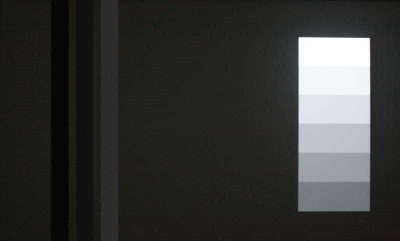

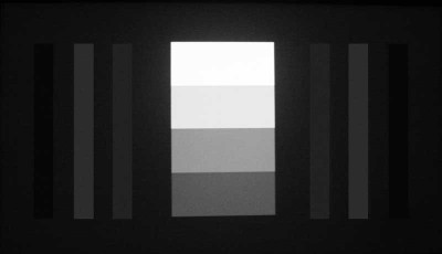

Blacker-than-Black (Below Black) Test Patterns
In order to see Blacker-than-Black test patterns, you'll need one of the discs below which will give you the ability to calibrate your display or projector to the correct levels. Remember, the proper level is such that the below black information, while present in the system, is NOT visible. TYhis means that you will want to make sure that the Below Black information comes through by cranking up your Brightness (black Level) until you see the below black pattern, and then decreasing Brightness until it is completely hidden, but leaves the next brightest pattern or line barely visible. Here are some of the common places to access a Blacker-than-Black test pattern:
